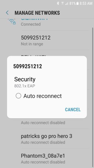

Found this WI-FI connection on my phone, not sure how it got there, and can't get rid of it .
"5099251212"
Googled it and found a few people are finding it on their phones and can't get rid of it. Some think its a hacker.
Anyone ever come across it any suggestions on getting rid of it.
Been said some have done a reset on phone and it still there.
What phone/OS is this?
On mine, at the bottom of that screen would typically be "More settings." From there, I can long-press on any network and then tap "Forget network."
Samsung S7 Nougat.
Any other wifi connection has "forget" network, then long press and its gone, but not that one..........

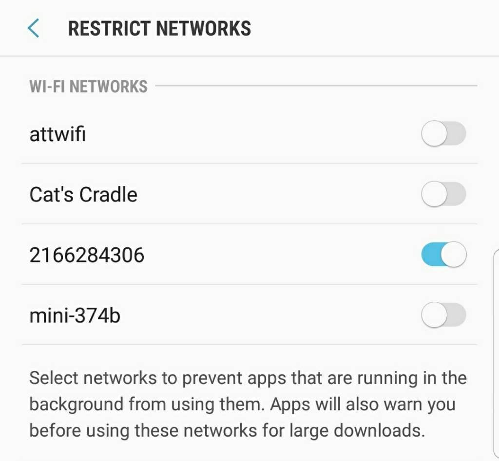

Interesting. Could it be your SIM? Was there an update right before this? Triggered me to look and found something similar I think.
Settings -
Connections. Data Usage.
Restrict Networks.
In there you might be able to block it.
Yes I did put a restriction on it.
I never replaced the sim, but when I googled the #, the page I was looking at with comments about
that mysterious #. One poster said they had replaced the sim, and it was still there. So for now I guess
I'll have to be happy with putting the restriction on it until I can find out who or what it is.
And I don't recall an update , but then again I just found this the other day. So how long its been there I don't know.

//uploads.tapatalk-cdn.com/20171212/1e2d88d4e8695138aad8b472bc80b9de.jpg
And it looks like you have a similar WI-FI# network on your phone.

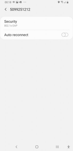

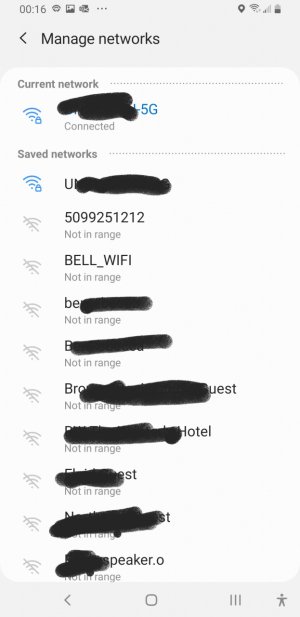

I have the same issue with a mystery connection "5099251212", was do apparently many many others, yet nobody has any solid answers
I'm running Android 9 on a Samsung S8+ (originally from carrier Bell Canada).
I did find a vague mention of this in a research paper (pdf attached) about malicious networks, but i'm not clear on whether it was implying that this specific SSID is a concern.
