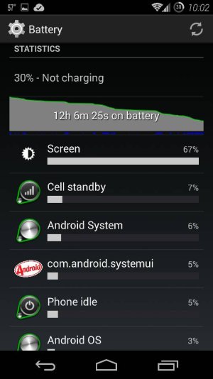

Screenshot as promised
From a Carbon M8 and AC Forums app

A 6 hour battery drop of 12% would be 2% per hour, equating to about 60 hours of standby time, or nearly three days. I am not inclined to think that anything is truly wrong.
Check out the screen shot provided by ejcrossl: They showed a chart that drained the battery 94% in 6 hours. That is a cause to be concerned.
