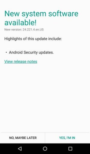

So that's the problem! I bought the X Pure at Best Buy Wednesday night and turned on the phone before inserting my Verizon Sim Card. I got the notification to update to the May security patch. Then when I inserted the Verizon Sim about an hour or so later, it said I had another update. So I went through the update process and it reverted the security patch back to the February patch! Now I'm stuck on the February patch instead of the May patch!
I wonder why Verizon isn't pushing out the May patch. I'm going to try to remove the sim card to see if I can still get the May patch.
Alright, I removed the Verizon Sim Card and the May patch appears again. I'm installing this patch and will be ignoring Verizon's February "Update" request.

Finally got tired of checking, so I pulled the Verizon sim and immediately received an update notification.
Really would be nice if "Pure", meant pure, huh?
I would never have imagined we'd have to pull a Sim to get this through...
