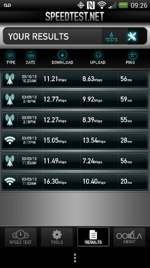

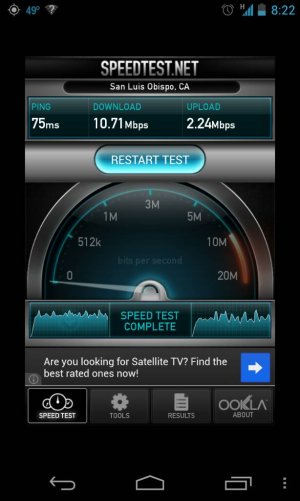

79 is a low ping? The highest I've ever had has been 59.
Sent telepathically from my padded cell via an HTC DROID DNA
LTE generally pings much lower than HSPA+.
P.S. This is a Nexus 4 subforum, so your results on a device that doesn't run on a GSM network are irrelevant.
I may not be using my DNA on GSM, but it most certainly does run on GSM.
We know your phone is capable of to run on GSM, but what he is talking about is the results based on THIS thread. OP's results are from HSPA+ on ATT which the Nexus 4 is only compatible with, not LTE, thus our pings will totally differ.
