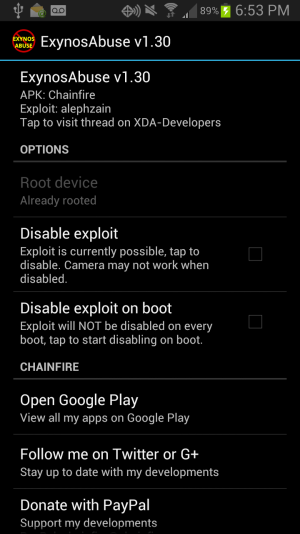

Im rooted aswell and when i go to open the app i get this
OK I figured it out. I had Ver 1.0 I had downloaded from somewhere at XDA the other day. The Ver here is 1.30, works perfect. Got the menu like posted above and have root. Thanks all.
