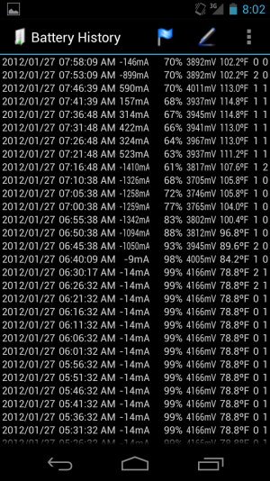

See the attached record log. From 06:45AM to 07:16AM my phone is drawing over 1000mA no charger attached. I then attach the 2.1A charger at 07:21AM with a charge only wire and now it is postive 300 to 500mA a change of about 1400mA. If it was only able to draw 1000mA it wouldn't be positive by that much, it would barely be even. If you don't believe the numbers from the Battery Charge Widget you can see the difference in the battery graph in the settings menu. With a normal USB cable you will be losing charge, with a charge only cable but a 1A charger it will barely stay even, with a 2.1A charger and a charge only cable it will gain charge.

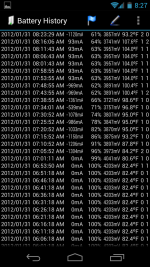

Now compare the previous data with this data using a charge only cable with a 1000mA charger. At 07:05 to 07:48 I'm off the charger drawing 900 to 1300 mA and losing charge from 99% to 62%. Then I plug it into the the 1000mA charger at 07:53AM and you see it positive by 93mA, not much and the charge stays around 63%. As you can see there is a difference between the 2.1 A charger and the 1 A charger. If there was truly a limit of 1000mA and a 2.1A charger doesn't add anything the data should both be the same.
