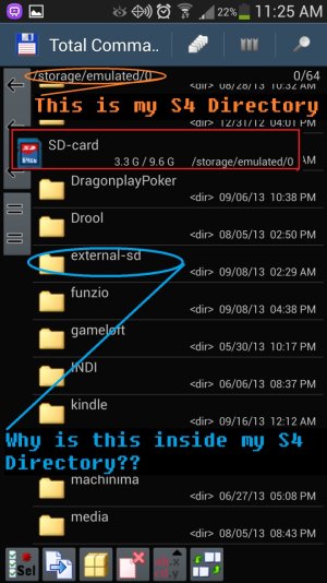

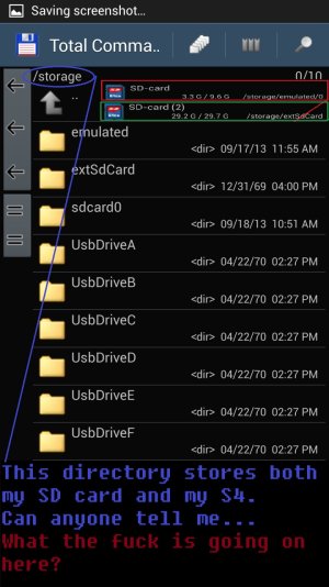

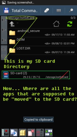

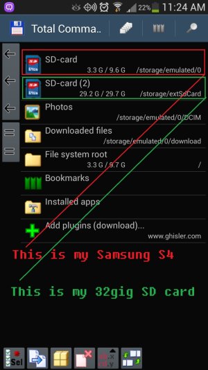

I am have been going crazy with this exact same issue. I am not going to attempt to explain what the hell is going on so people can actually start helping!
My Samsung S4 basically sees my SD card, but does not treat it as if it were the external SD card.
Can anyone explain what is going on here?!

I can't see your attachments, but can give you some thoughts on the issue. The Android file system appears to be very convoluted. There are multiple file locations identified as "sdcard," with some being the external SD card and some being within the device's internal memory. Also, even if you find the actual SD card using a file app/browser, as best I can tell if you have apps on the card they won't be visible. I just installed a new SD card last night, then "moved" a bunch of apps there. I can't see them when browsing through the files on the phone with a file app, but I know they are there because I haven't put anything else on the SD card yet but the storage usage info. shows that there's something over 150MB on the card, even though the visible folders and files account for only around 4MB. The amount shown as used on the SD card comes pretty close to the total for apps on the SD card as shown in Application Manager.
I can't see them when browsing through the files on the phone with a file app.
If you plug the SD into your pc and allow your pc to see hidden folders you should see them in I believe it's a folder called Android secure. I'm away from my pc but I think that's the one. It's hidden.

There's no emulated SD card on S4, ?emulated? is just a term used in Android file system for various purposes.
Just moved 200-something MB of apps to external SD (thanks for reminding me to do so!), the SD actually went from 7 GB of free space to 6.8.
