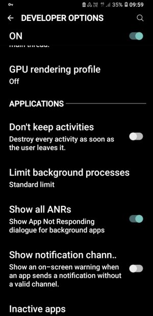

Some devices have a "don't keep activities" option. This means when you leave a page, the device "forgets it".
Perhaps you have this function. It's in developers options in settings..
It looks like that in my Samsung...

Thank you for this setting. But it is disabled as shown in your screenshot. And the "limit background processes" is also set to "standard".

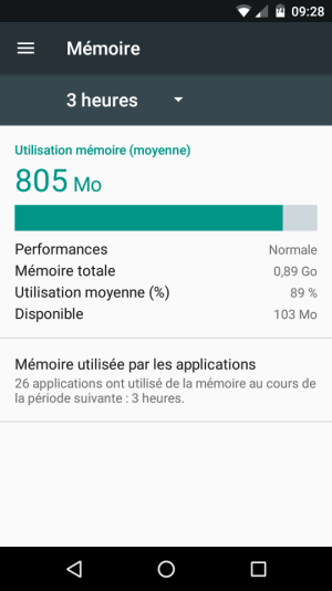

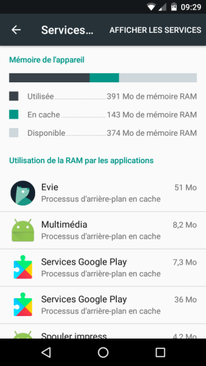

I should also mention that there is a difference between the value of free RAM shown in Settings -> Memory and the one in Developer Options -> Running services -> Show cached processes.
Both screenshots were taken a few seconds apart, just after waking up so no apps have been used for 9 hours. Do you know why I have 103 MB on the first one and 374 MB on the second one?

I should also mention that there is a difference between the value of free RAM shown in Settings -> Memory and the one in Developer Options -> Running services -> Show cached processes. Both screenshots were taken a few seconds apart, just after waking up so no apps have been used for 9 hours. Do you know why I have 103 MB on the first one and 374 MB on the second one?
The memory screenshot is showing an average for the past 3 hours. You may not be actively using apps, but they would still show there if they are initialized in the background. The running services is more of an immediate snapshot. When you started using your phone, it activated more processes.
