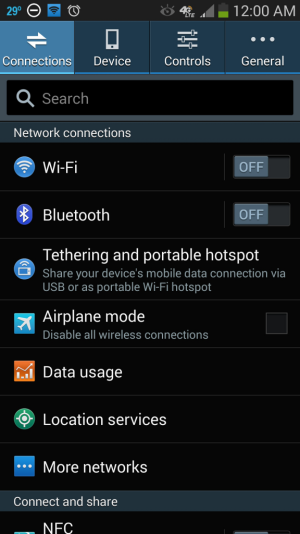

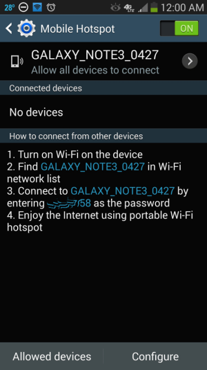

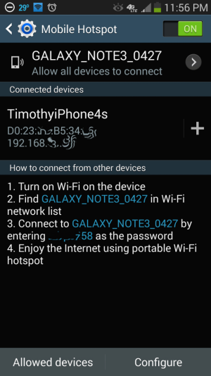

I use Hotspot Toggle--the full app, not the widget.
  • Click on the app. It will come up with the message that it's "verifying" and then it will tell you[';./ to call AT&T or dial 611, blah, blah....pay it no mind.
  • Just click the home button and you'll notice the icon in the notification bar is still there...because the hot spot is still active
  • Then just go to the menu button>settings>Tethering and portable hot spot - click on it.
  • Click on Mobile Hotspot, not the ON button but the wording
  • Then follow the onscreen instructions and enter the password it provides on the device you wish to tether to your phone. See below
  • I connected my iPhone 4s that has no dataplan and is being used by my kids as an iPod Touch. Viola! Works great.
