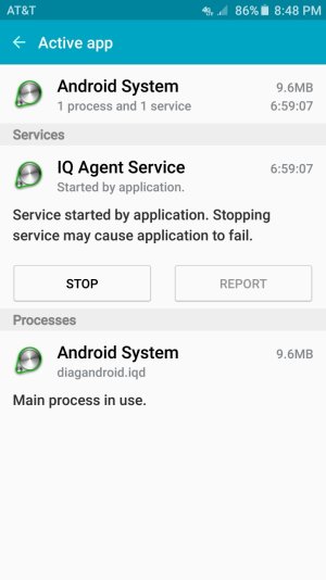

I am desperately looking for a 64GB N920i in black to use my AT&T sim card in. I found some VERY disturbing spyware installed in my AT&T version by AT&T so it has been returned.
Carrier IQ
It cannot be deleted, disabled or uninstalled from the Note 5, you can "stop" it but it reenables within minutes. It is also a big battery and RAM drain. It sends constant feedback to AT&T about everything you do on your device.
Carrier IQ is a Sunnyvale CA based company, and a TERRIBLE company at that.
Here you go:

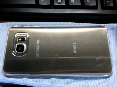

Hello. I'm from Poland and I have Samsung Note 5 SM-N920I. I broken screen in my phone and I can't found parts for it. I found LCD screens for SM-N920F, SM-N920T, SM-N920A, SM-N920P, SM-N920V, SM-N920R4. So I want ask you that screen in my Note 5 will be compatible with other versions. I'm sorry everyone for my bad english.
