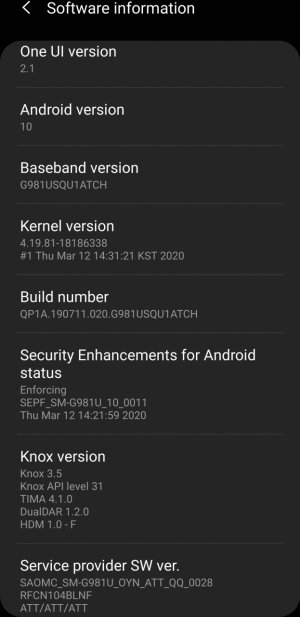

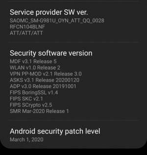

I've been reading up on using Odin to upgrade my Samsung which is stuck with an old OS, and I'm comfortable (I think) with that. However, I have a question regarding which firmware package I should use.
My ATT Samsung S20 is outside of the US and ATT's service, so it’s never received updates. It has one of the older Android 10 March 2020 updates currently installed. The most current firmware updates are for Android 12. Can I download the most recent Android 12 update and directly flash my old Android 10 to this one? Or, do I need to do this incrementally, by first flashing to the most recent Android 11 update available, then flashing to the most recent Android 12?
Thanks for the advice
Thanks for the welcome and prompt response Mustang.
Here are the screens you requested.
I was going to download the updated firmware from Samfrew https://samfrew.com/model/SM-G981U/region/USC/ My current software is way at the bottom March 2020 (G981USQU1ATCH). I want the the most recent June 2022 update (G981UOYN2FVF1). I just wasn't sure if I could go directly from Android 10 to 12, or if I needed to first update to 11, then 12.

Welcome any questions let me know, it you decide the unlocked firmware grab the latest Odin called Patched B(Prince Comsey) use in the CSC slot of Odin the home CSC firmware so doesn't factory reset
Back everything up through Samsung smart switch on pc prior to doing anything
