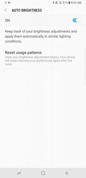

Did you go into the settings and reset the feature? It learns where you prefer it when you adjust the sliderScreenshot_20171203-080455.jpg in different environments.

Did you even try what is in post 29 of this thread? If auto brightness doesn't seem to be working, reset that feature so it will learn your usage patterns again.
