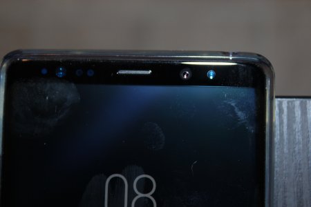

Can you show us a picture of the top part of the phone? The proximity sensor is typically right next to the front-facing camera, so if the case goes up to where the bezel and screen meet (which is below the front-facing camera), then it might still be blocking the sensor.

Here's a couple of quick pics I snapped. I'm not convinced it's an auto brightness issue as it affects the proximity sensor's function as well when I'm making a call; but I guess I can start with resetting usage patterns.

I misunderstood how you described the case -- you had said it went down to the where the bezel meets the screen (which would be the top edge of the screen itself, not where the metal meets the glass at the very top of the phone -- in phone parlance, bezel refers to the blank border between screen and the edge of the phone). If that were true, that would mean the case would be covering both the proximity sensor and the front-facing camera, which wouldn't make much sense.
Ah, gotcha! I wasn't quite sure what it was at first; but now that I have my case off it does just look like it's the metal band around the phone. I'll check out those sensor apps and see what they say.
