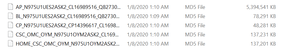

Then I downloaded the firmware for my Note 10 model (Make sure you have the right model number). I got it from SamMobile. Put the phone in DOWNLOAD mode.
Once downloaded, unzip the firmware. You should see these files: AP, BL, CP, CSC, Home CSC as seen here:

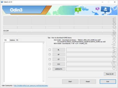

These will go in their corresponding letters in Odin as seen here:
For the CSC tab on Odin you could choose CSC or Home CSC. CSC wipes all your data and basically starts from scratch. Home CSC updates the phone but keeps your data. When ready, connect phone to computer and hit start on Odin. Let the process run.
**Important note** Going up from android 9 to 10 Home CSC kept my data. Going down from 10 to 9 DIDN’T work for me and I had to do a factory reset. Again, make sure to back up data!!!
