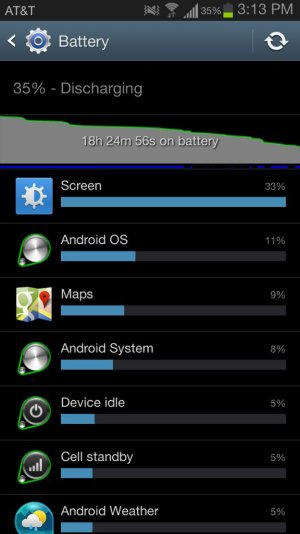

When I got home ~ 740 pm, battery @ 64%. There was a rapid drain to where the battery was dead ~ 1 am (6 hr later). This only happened the last couple nites. Here is a screenshot:
Where it says "14 h 5 m..... battery", right above the "e" in "battery" is probably when I arrived home. You can see the more steep downward decline. I disabled Samsung push as someone suggested above. Tomorrow, I will take the battery out and reseat it.
