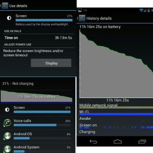

I'm seeing 12-17% drain per hour, depending if I'm using the phone or if it's sitting idle on wifi with screen off (~12%/hr). I did a hard reset with nothing but the stock apps running and screen at minimum brightness and no change. I'm debating sending the phone back as a defect and going back to my Galaxy Nexus in the meantime, which has 2-3x better battery performance in my experience. The screen off/idle fast drainage is what's most puzzling to me.
I'm trying to read through this thread and figure out what is normal for the Nexus 4. For me, I'm not able to hit 7 hours of light usage with the screen at minimum brightness.
This is precisely me. My phone is dead within 10 hours no matter what I do. The battery drains at a remarkable rate, and nothing I do stops it from doing so. I've even reset it, no luck.
Can either of you guys install GSam Battery Monitor, use it for a day, then post both the main battery usage screen and App usage? Even with stock apps sometimes Android can do weird things like Maps can randomly drain a lot of battery searching for your location due to latitude etc.

I posted a ton of screens from GSam here: http://forums.androidcentral.com/go...fe-horrible-major-drainage-4.html#post2385688
This was after a worst-ever evening where it bled 90% in about 8 hours of just sitting there. Last night's result was to lose 35% in about 6 hours; still pathetic IMO. I'm used to losing 8-15% overnight (5-6 hours off charger), but this is pathetic. I had to use my GS2 when I went out in the morning because the N4 was starving for juice. Now that my GS2 was borked by a buggy GSam update last night, I'm down to just the Nexus and that's not good. Next step is to Airplane Mode it while sleeping, but what if I need to receive an emergency call? So lame.
