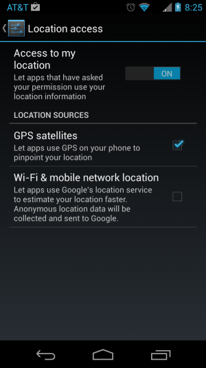

Update: I unclicked Wi-Fi & mobile network locations from the Settings->Location Access and turned off chrome sync through pressing microphone->settings->Voice->Google Account dashboard on my phone. I charged my phone to 100%, left wakelock detector on, and unplugged my phone an hour ago. I just checked my phone and it is still 100%. I am going to keep monitoring my phone to see for any changes, but so far this is a BIG improvement.

Update #2: Battery dropped to 98% after 2 hours with those settings off... Definitely lesser idle battery drain, but this should be lesser. Wakelock detector detected 24 wakes with facebook and 30 wakes with google search with 2% awake. This is better than the 64 wakes i use to get in 2 hours. I am at 2 hours and 13 minutes on battery with wifi at top with 30%, android os 23%, screen 22% with 3 min and 41 sec
Edit: If i do the math with 2 hours screen time, that would be 3% Android OS idle plus whatever Android OS I used in that 2 hour screen time.
Doesn't that prevent apps like Google maps from estimating your location when GPS is off?
Sent from my XT1053
nope but that does prevent google from knowing your phone when you lose it. However, if you use motocare website you can turn it on remotely and find your device.
For me Google maps location doesn't work if I turn that off.
Sent from my XT1053
