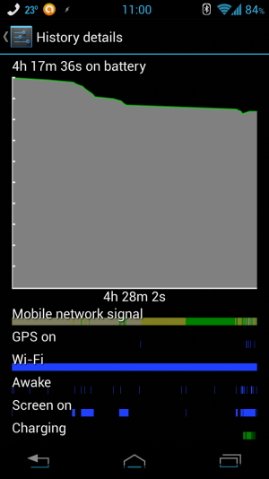

I'm using conservative now on that kernel. The adjustment variables aren't too hard to understand. It raises or lowers frequencies one step at a time depending on processor load. You can set the load to lower and raise as a percentage. The trick is a balance between performance and battery. If you set the trip level to raise frequency to low, you get good performance, but lower battery. If you set it too high, you get performance lag. On the trip level to lower frequency if you set it too low, you're wasting battery. If you set it too high, the processor won't keep up with demand and again you get lag.
I think 45% down-threshold and 65% up-threshold are a good balance to start with. I've been playing with 50/75 for the last couple hours this morning. You can see that the idle on screen off is working very well so far.
