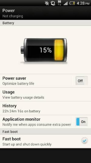

Battery after JB
Really good battery life after JB love it
