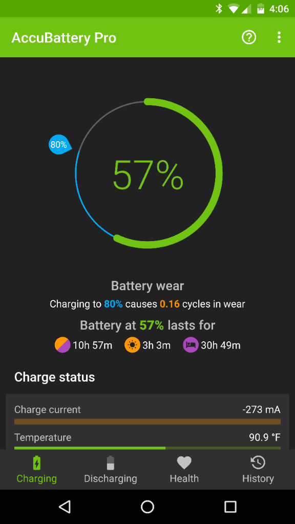

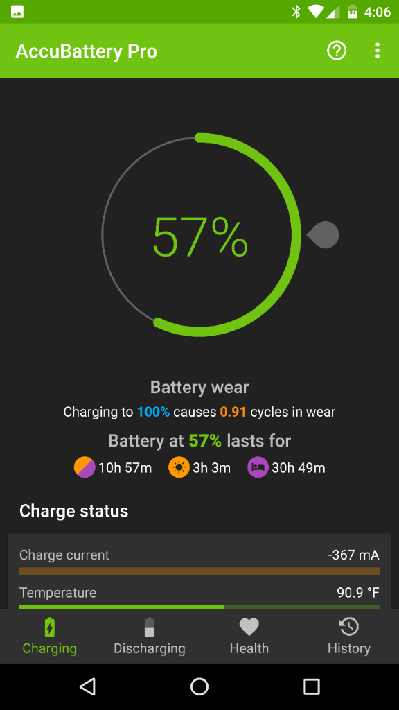

However, there's a common misconception that just plugging your phone in counts as one charge cycle. It actually depends on how depleted the battery is when you start charging and how fully you charge it. If you believe the folks at AccuBattery https://forums.androidcentral.com/e...s?id=com.digibites.accubattery&token=OXIr7SjP then see the attached screenshots for an example: the cycle count 'cost' in both examples start at the same depletion level, but one ends charging at 80% full (0.16 cycle cost) and the other at 100% full (0.91 cycle cost).
You be the judge...

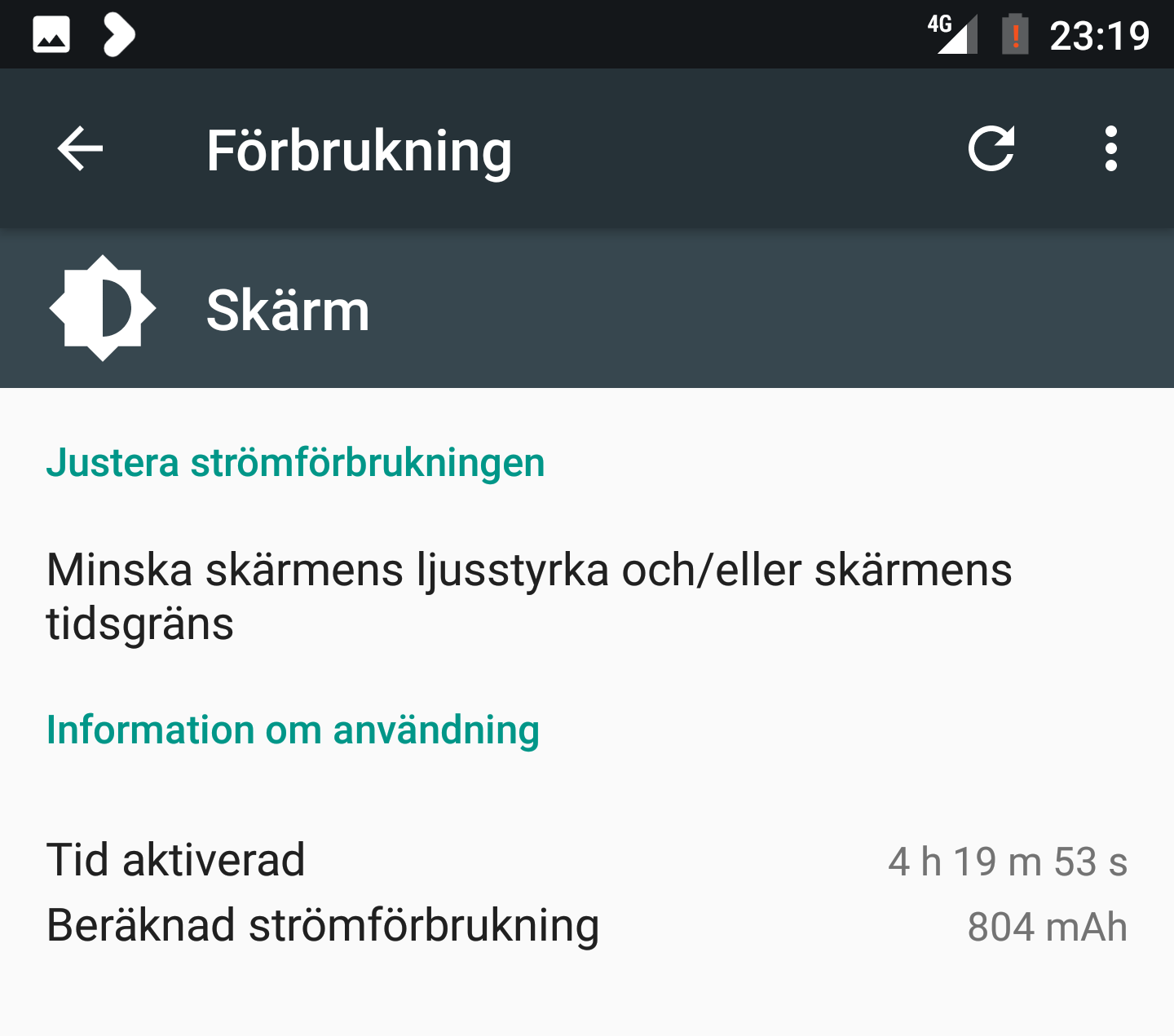

Yes, give it a shot. It's totally worth it to replace battery. Mine went from SoT averaging around 2:30 to almost 4:30 yesterday. That's on 3rd full charge cycle after the replacement:
