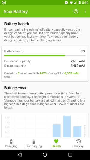

What does the Health tab in AccuBattery show you? It should look something like this:
Here what it says this morning. Yesterday for the first time I had to charge it 3 times and I didn't even use it..
It takes a few day's worth of charges for AccuBattery to build up an accurate model of your battery health. Stick with it for a week or so and see what it says then.
