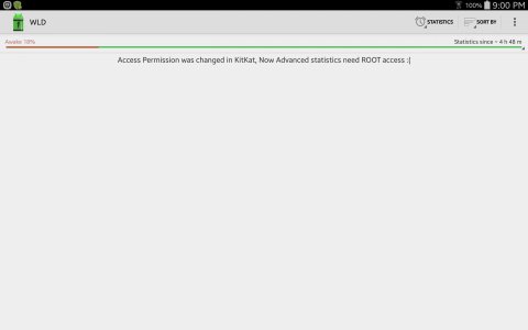

Will try that Wakelock detector and see if it helps.
Thanks
Is it not working properly or something I get this message. "Access Permission was changed in KitKat, Now Advances statitistics need ROOT access :("
That is telling you that an app needs root access to function. Maybe "Advanced Statistics"? If you aren't using that app just uninstall it.
Sent from my SM-T320
Its not showing anything because it isnt working. It is telling you it requires root access to function. Just uninstall the app.
