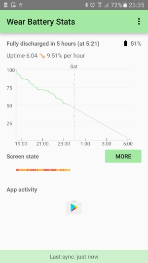

First of all.. Sorry for bringing up this subject again, but I cant seem to get any decent results with the watch.
Battery is draining 10% an hour with the following settings:
Brightness - 3
WiFi - off
Gestures - off
Always on - on
Cloud sync - off
Send diagnostics info - off
I've attached the battery stats.. Not sure if this helps.
Appreciate always on isn't going to help, but people are getting great results even with this setting on.
Any help would be much appreciated, only had the watch a few days, so still learning!

Thanks for the quick reply.. If I factory reset, is there anything I should be doing differently when setting up? Obviously don't want to do the same process in case the same rogue app pulls through (if that's the issue) again appreciate the reply!

Definitely should factory reset. Don't know what else you might do differently tho. I find I rarely need my brightness above 1.
What watch face do you use? Some watch faces will waste more battery than others. I ended up just sticking with one of the preloaded watch faces, for what that's worth.
