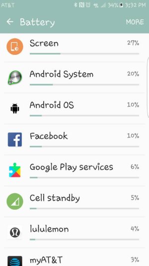

So I'm down to 34% with only 6 hours of use. On and off use, not constant. Just general surfing FB and the occasional app.

Location, news apps, and some of the Google apps, e.g., Play Newsstand, can cause battery drain. Check the settings. Some of these apps, even if you've never used them, keep updating in the background.

I'll blame it on your poor signal, NFC on, and Bluetooth on.
The poor signal is the biggest culprit I think. In a poor signal area like that, with 4G on, I'd expect AT LEAST 3-4% standby drain. And that's when not using the phone.

It may be a rouge app. I hated my S7Edge so much at the time because of battery drain that I bought a iphone 6s plus. I recently wiped my edge and installed apps one by one and ran a few tests and found it out it was GasBuddy that was draining my battery to no end. Get Gsam and monitor your battery and see how long your phone is awake. Alternatively, go to settings, applications, click on apps, at the very bottom of app use you can see if the app has been using your battery and memory and for how long. Hope this makes sense.

Dont know if anyone else has this problem. But for me atleast, google hangouts was constantly updating in the background and absolutely demolishing my battery life. After disabling it has drastically improved.
