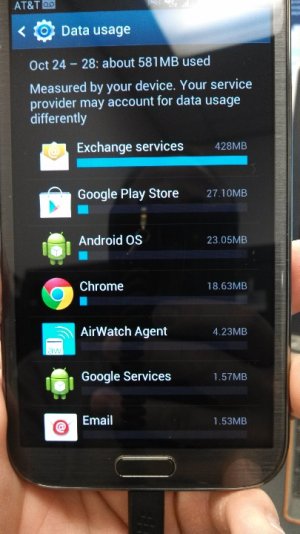

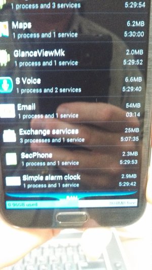

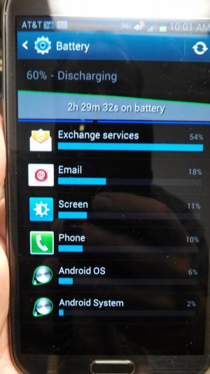

Has anyone experienced this issue? I've seen some write ups on other sites that implies that it's an bug in the Samsung client software. I have a customer with this issue and trying to figure out if I can do anything to resolve it or not. Came to me saying the battery was dying quickly. I quickly realized that the Exchange account server was using 55% of the battery and looking at the data, accounted for over 400MB of data. This just isn't right. So I deleted the customer account, added mine and charged the battery back to 100% for testing. After adding my account, I checked the Running Apps and it still looks like it's using way too much. Exchange Services using over 25MB and Email around 40MB. Doesn't look like that on my Motorola RazrMaxxHD running the same Exchange email account. On my Razr its only 8MB on one and 7MB on the other. Something is wrong and I'm looking for suggestions. Should he return this thing or what?

Well I added my email, disabled a bunch of bloatware apps, changed to a darker wallpaper, turned on the power save mode. I even removed the 'Shortcuts on Lock Screen' option. Same results. Battery at 50% left after only 4 hrs of very light use and the Exchange Services are back to being over 50% of the battery usage. Probably sending this one back.
