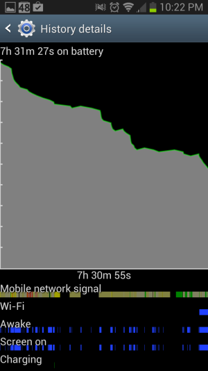

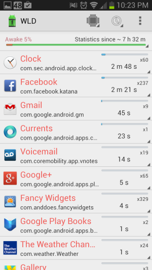

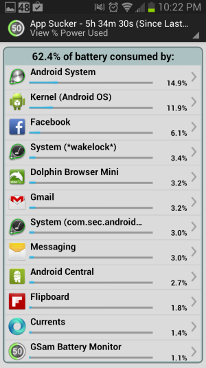

Second, fully charge the phone, unplug it, use it normally until the battery is down to 50% or less, the do screen captures of the 3 standard screens you'll see in almost every battery thread. Without data, we can't do more than offer random guesses.
Printing screens from wakelock detector, too, couldn't hurt.

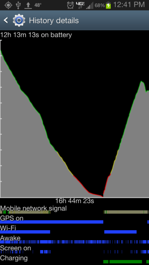

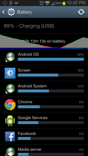

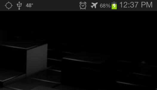

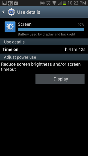

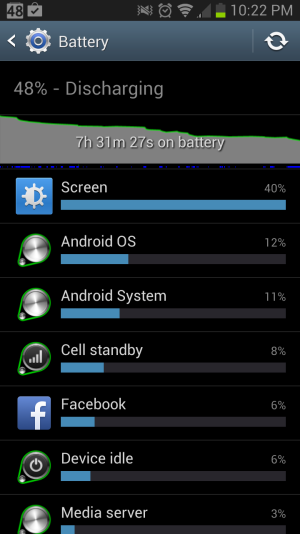

My battery drains even in Airplane Mode. But I think GPS is stuck on for some reason. Is there a way to tell what's activating GPS? Phones should last forever in Airplane Mode. If mine isn't on a charger overnight, its dead and off in the morning.
I've noticed my gps stuck like that too a couple times, if you toggle it off and wait a while it should reset the radio when you turn it back on. Try that, and then if can, boot into recovery and clear your caches, especially your dalvik cache. Hopefully that can clear things up.
