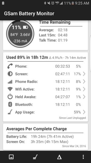

Anyone want to take a stab at whats going on with mine?
I can almost never get over 4 hours SOT and I have to charge around twice a day.
App usage seems to be the culprit but I cannot figure out what it is
Verizon, Location set to high accuracy ( but according to GSAM it wasn't really used much at all).

In a 18 hr period, your Held Awake time is unusually high. You should install wakelock detector lite & check out what's keeping your phone awake.
