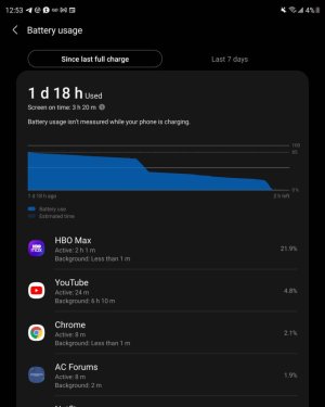

Getting almost 2 days with 3.5 SOT only charging up to 85%

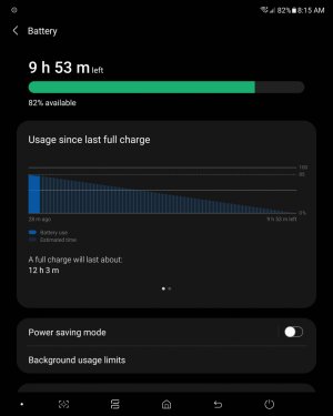

Mine doesn't show screen on time, see attached.
I used to get values like that, now it's a bit over 12 hours.

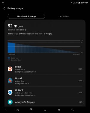

I did the charge to 85% thing last night, I'd read that it's supposed to say 100%, but took it over the charger about 20 min ago, have only been reading the news and this site, no videos, I don't game, I use dark mode everything that I can, and I've got this:
Ok, found screen on time... Derp...
I wiped the cache partition since my post above, maybe that will help.
Still... 52 min since charge, 35 min SOT, power went from 85% to 76%...
