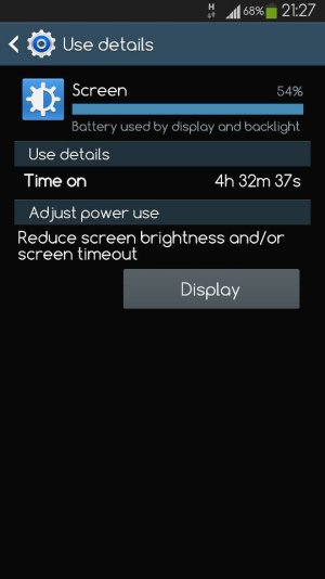

As garublador mentioned, it would help to know your total screen-on time. Tap the Screen listing, and it should give you those details. Average usage for the S4 should probably give you around 5-6 hrs of total screen-on time (others with an S4, please chime in if I'm wrong).
On screen time on S4 x
Sent from my GT-I9505 using AC Forums mobile app
I'm going to guess you were charging the battery at the time. Your battery percent went up 2% and your on screen time is incredible for only losing 1/3 of the battery. Nothing in your stats looks out of place. 4.5 hours of screen time is a lot so everything else will look pretty minor compared to how much battery the screen has used.
Unless of course you haven't actually used the phone that much. Then it looks like something is keeping your screen on.
Yeah, something seems a little off there. 4+ hours of screen-on time with 60+% battery left is very unusual for a phone, unless it's some kind of extended battery.

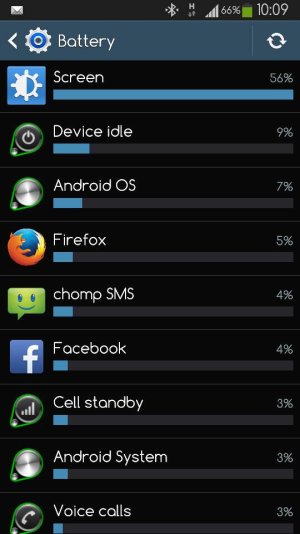

This is mine after 7 hours is this good or bad?
Sent from my Galaxy S4 on Tapatalk
http://img.tapatalk.com/d/14/02/14/eparujah.jpg
Very decent battery life imo , It looks like there was a wakelock for about 1 hour duration , have you identified the source ?
I think you will give much better battery life if you can fix that wakelock.That would bring awesome 4h screen time.
I get around 4 hours screen-on time and 8-9 hours standby with brightness above 75% throughout sometimes 100% all the time (No task killers , No battery saver apps , No Anti-virus)
