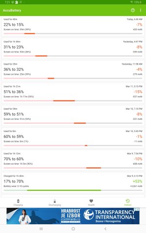

Here is the SOT,which I suppose ain't that bad.
Only battery health reported by AB lost like 3 % from 98% to 95%.
So what do you guys think?
SOT was like 25 % lost of battery watching 3h 1080p youtube videos at medium brightness though with POWER SAVING ON.
Yep hope so.Probably I left last time tablet ON and it discharge the bat to 0 %.
Though Accubattery reported health previously to 101 % which I don't think was true.
I lost few % but that s about it.

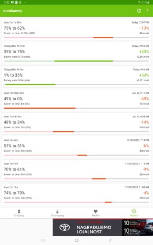

I used the tablet for 3 days watching yt 1080p video at lower then medium brightness with power saving mode ON.
I charged the tablet before this to 70 % and discharge to 15 %.In total got 394 minutes of SOT.
99% of time used for watching 1080p video.
I guess ain't bad,huh?
Here is screenshot from AccuBattery.
Looks fine to me! If you plan to keep the device in storage again, just set some reminders to power it back on maybe every 6 months to check the battery level.
