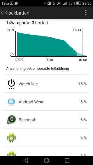

Battery life for me was solid after the update but has steadily decreased, seemingly timed with Android Wear app updates. Timer seems to cause some major drain... The graph shows normal drain, then sudden accelerated drain until dead in a couple of hours. It's happening more and more. I'm hopeful 5.1.1 will fix some things.
