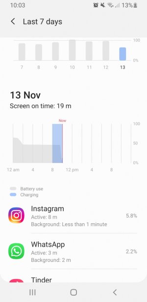

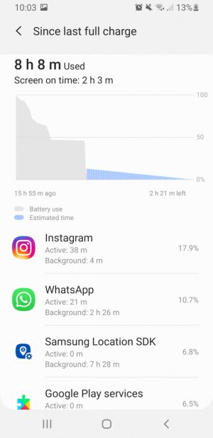

So for a little while now my battery life has been a bit weird. Its got to the point my phone will drop from 40% or around that to dead in seconds. I gave had the local phone shop replace the battery twice (with genuine batteries), and nothing changes. It is worst when I go to bed with anything around 50% battery and put my phone on airplane mode like I do every night. When I turn airplane mode off and start using the phone it dies within a minute. I've taken screenshot of the battery monitor too.
