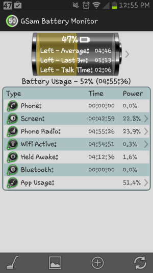

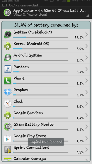

Hi,
I'm new here, so my apologies if I'm not in the correct area. I have an S3 and my battery life is just horrible. Has been for a while now and I'm now just trying to be pro active about it. I'm running gsam and I get the info below. Does anyone know if what you see is leading to my ****ty battery life? If so, how can I fix it?
Some more background info: typically use wifi, screen timeout set to 15 sec. No NFC enabled and most sync is turned off and email syncs are set for once an hour. I hardly use the phone. For example, I have two batteries and I just swapped them out a handful of hours ago as the battery was dead. and now it's already at 47%. The phone is just sitting here on my desk with the wifi enabled. No blue tooth and gps. I also have power management enabled. Oh and I restored my phone yesterday to factory settings hoping that would have solved it, but no. One final piece of detail. My usb connector on the phone is busted. I can only charge my batteries with my external charger that came with my additional battery. So rooting the phone/tweaking it through usb is not doable.
Any help would be much appreciated as I go through 2-3 batteries a day.

Yikes, zero bars at home AND work? Maybe it's time to look into switching carriers! You can get an idea of how much time your phone is spending searching for a signal by going to Settings/Battery, and tapping the "Cell Standby" listing. It will tell you the percentage of time without a signal.
Yeah Sprint sucks here in the Silicon Valley. Contract isn't up until August and I have been considering it as my reception is horrible indoors and non-existent at home and work. I just checked my time without signal and I'm at 75% without signal. ****! Since I'm mostly at work and at home, I'm probably spending 75-85% of my day without signal. **** me! Never really thought about it until now.
