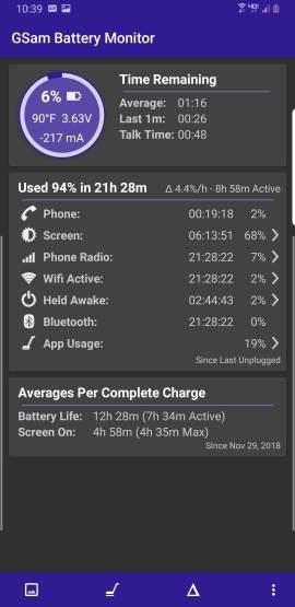

Battery life stinks.
I'm sure bxactions has been updated since I tried it but I uninstalled it right away because it massively killed my battery.
After disabling it it's using zero battery since the last charge.
On that subject I have 15% battery life left with just over 4 hours off the charger.
With my last bunch of phones I've generally ended up in the 50-60% range after a 10h shift in the ER. With my S9+ I routinely end up at 40% or below with pretty much the same apps, location and use

OP are you using a Exynos model? Those are known to have worse battery life than the Snapdragon models, although yours seems truly bad.

Nope. Unlocked US model from Amazon. So far it's getting worse.
What kind of battery life do you get?

Actually even for an Exynos model that's horrendous. I have Exynos and I according to Accubattery I get twice that time on 3h30m screen on.
The only reason I can see for the bad battery in his latest post is the bad signal. There's practially zero on the bar.

That was in the middle of my house. Dead zone. Although I was connected to WiFi calling. I'm not sure if that makes a difference or not. Poor signal shouldn't cause that much of an issue. I've had other phones that didn't drain like this one does.

Actually poor signal does do A LOT of battery drain and it SHOULD cause that much of an issue. It is known to be one of the biggest causes of battery drain. This antennas are designed to try to query as much for a signal as possible especially since AFAIK you're in the US and they're killing GSM there. 4G/LTE uses A LOT of battery at low signals. Phones are supposed to let go of 4G and fall back to GSM connections in low signal cases just because of this specific battery consumption problem. If your older phones were able to fall back on GSM they won't be killing thr batteries.

iPhone 8s and now a OnePlus 6T in the same setting lasted me much longer. The iPhone would last almost to 5 or 6 pm daily. This the 6T is trending to last till after midnight.

If those phones are falling back to GSM and there is GSM signals in the area, then they'll save battery.O know for certain iPhones still have the GSM antenna. Not so sure about the 6T, but the 6T does have versions with GSM capabilities. Have you checked your S9 if it has the correct GSM capabiltiies for your area?
We could also do a little experiment. You have WiFi, and your calls go through WiFi, so set the phone to airplane mode with WiFi active and see if battery gets better.

The S9 is an unlocked US phone from Amazon. I checked the website and it said it will work on GSM and LTE networks of T-Mobile. I checked the specs and it does have the GSM radios that T-Mobile uses. Besides if the cell radio was draining the battery shouldn't it show up on the graph? When it did show it was around 1%. And the 6T is a world phone out lasting the S9 easily. Sitting at 41% now with 11 hours since coming off the charger.

In any case, the 6T SHOULD outlast the S9 easily. It has a larger battery (3700mah vs 3000mah). But what we have so far established is that your S9 is having battery problems. You have an unlocked US Phone which has a SnapDragon 845, which should mean that your phone should have been lasting longer than my own Exynos version which has a known kernel scheduler issue causing decreased battery life for it compared to the SnapDragon version, and yet I'm lasting 13hrs standby on 3h30min screen on time. You should have been seeing something like 17hrs on the same screen on time.
Anyway, it shouldn't hurt to do the little experiment I suggested. It could point out that there might be a problem hardware wise on your phone and you could want to ask for an exchange.
The effect on battery as a result of poor quality cellular signal is known but isn't going to show up in battery stats.
Using wifi calling instead is one way to alleviate and tell you.
Q: you are using a sim you've had from before. Is it possible it is an issue?
