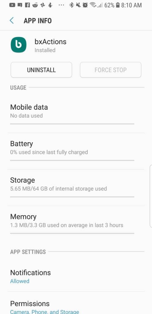

Today it is draining fast. It's also getting slow and laggy. I've been checking GlassWire to get some insight. I noticed Bixby Home and Google Play services using 500+ mb in memory. I have a habit of flipping through my screens. Inadvertently going too far to the Bixby home screen. I have BxActions loaded and remapped Bixby to Google assistant. Every time I flipped too far it's a stall before Google assistant comes up. I turned the BxActions off and it's much faster. Too soon to see what effect on the battery is.

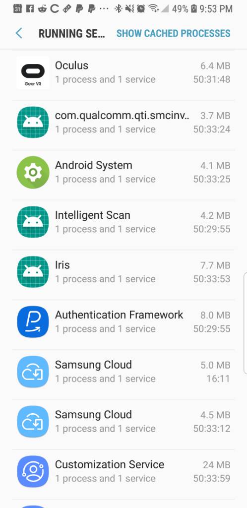

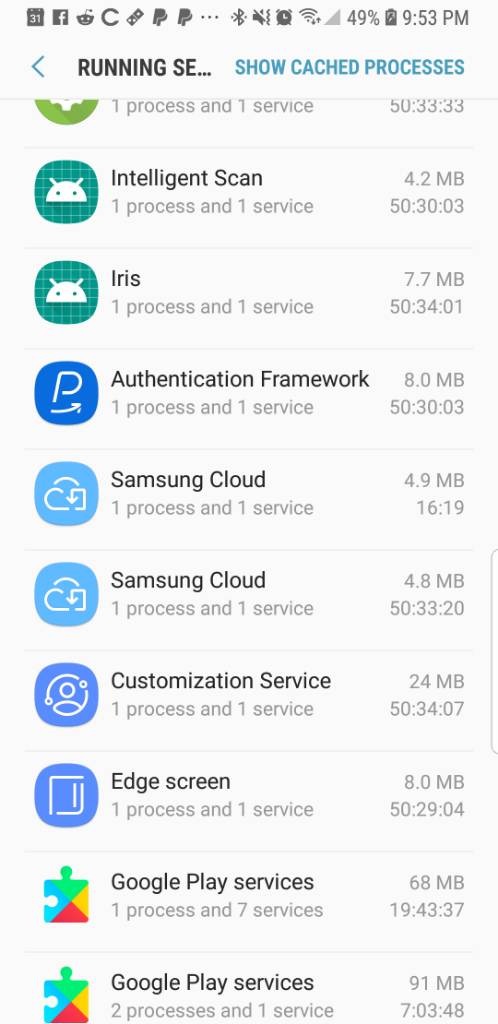

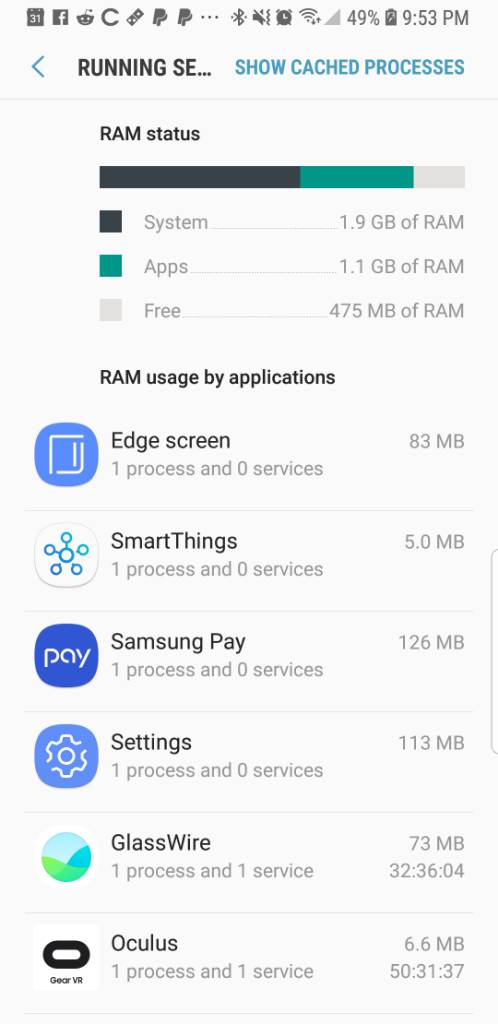

Go to settings>developer options>running services then post a screenshot here. It sounds like everything is fine on Safe Mode, so I assume there's some rogue app running loose. As for Bixby Home on swiping too far, pinch out on your homescreen and swipe over to Bixby home while in that mode. There's a toggle on the top that appears turning off access to Bixby Home from the homescreen via swipe.
Oculus always runs. But I don't use it.
That's weird. I thought that bug was fixed. Oculus doesn't run up on mine. There was an old bug from last year that Oculus or other VR services would run amok and kill the battery. Disable Oculus in the apps menu or see if you have a software update.

Ok. I had many Oculus apps running. Now that I think about it almost daily Oculus browser asks premission to run on two business Gmail accounts I have syncing to my phone. I force stopped all of them. There wasn't a disable option. I also force stopped BxActions also.

BxActions should be fine. If you have it setup it doesn need to be running always. But I don't think it has a lot of battery drain.
I'm sure bxactions has been updated since I tried it but I uninstalled it right away because it massively killed my battery.
