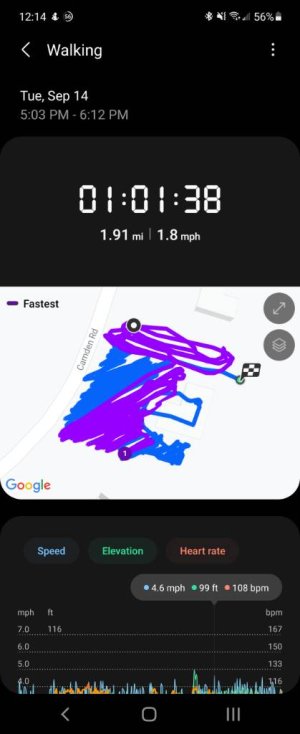

Does it actually pick up your steps? Does some steps, but misses a lot of steps for me when mowing.
I set the workout to walking. But there have been times where it has automatically detected walking after 10 minutes.
Yeah, I usually let mine autodetect when mowing. I'll try walking the next time. I'm curious to see my mowing pattern plotted by GPS. :D
