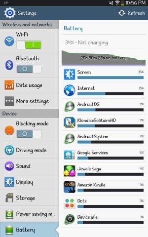

I timed it and I lost about 10 percent in one hour. Does that seem normal for just surfing using chrome?
