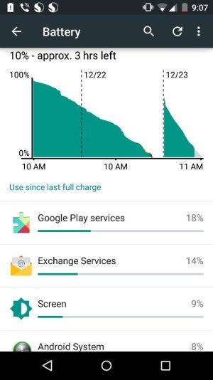

Went from 69% to 10% overnight. Seems there is a battery demon in my phone and I need to exorcise it out. The bad news is that I am not a priest...

I can do a factory reset no problem, but as you can see from the uploaded photo, Google play services and Exchange services are working overtime.
At the same time I had installed the BatteryGuru, which in all honesty seems to be doing absolutely nothing to preserve my battery. In its settings, one can select to stop all apps from refreshing when inactive, and I have it as an active option to happen just 15 mins after last touching the phone...

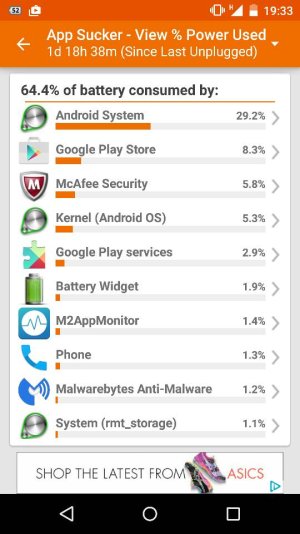

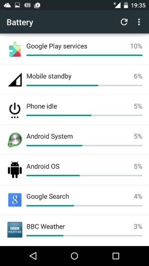

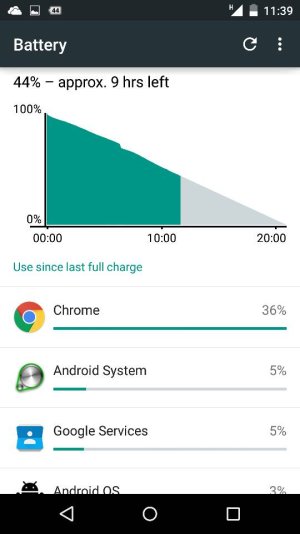

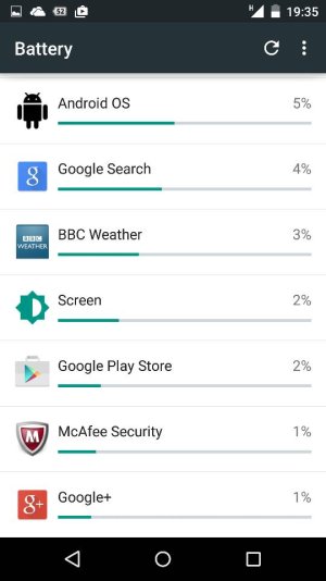

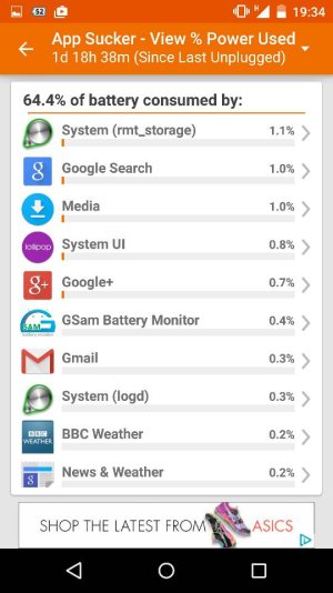

Also, can you trust the Lollipop battery stats, or even make sense of them? My N5 is not being used as a daily driver at the moment, but here are the stock battery usage stats and the GSam Battery Monitor ones for the same period. Make sense of them if you can.

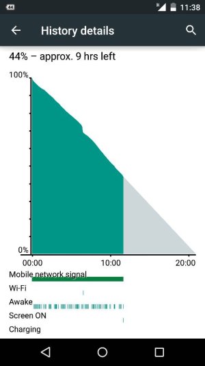

Another strange behavior. Left the house this morning and the battery level started decaying without even me holding the phone in my hand. Any ideas why?

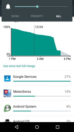

....And what Christmas Day joy on waking my phone:
^^^DOH!
Well I've force stopped Chrome at least.
