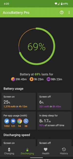

Accidentally left my phone on Extra Dim for a few hours. Geesh look at my SOT!
