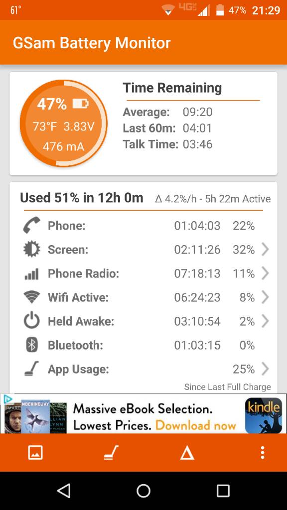

I wish I knew, I am still noticing improvement on the battery life. Whereas before I couldn't get through a workday I can at least unplug in the morning and plug in at night before bed with about 10% remaining. Still frustrating since I purchased this phone under the pretense of the awesome battery they advertised.

My thoughts exactly. The battery on the T2 is adequate, but not great. I just wish it was a little better.

The T2 seems to have a problem with the display using a lot of battery. I can't believe that m will have much of an effect, if at all, on display power usage.
