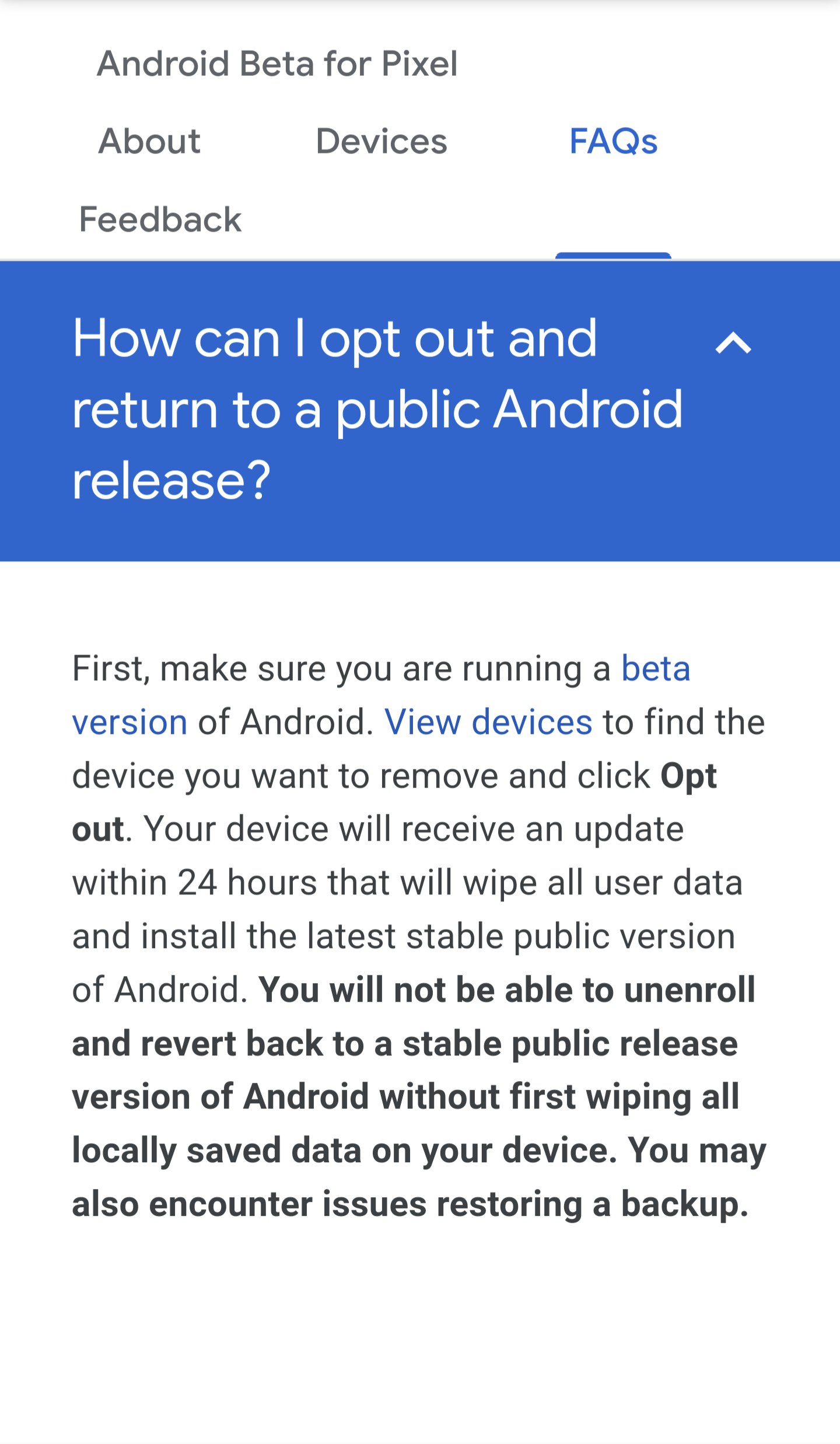

When you opt out your phone will receive the public stable release and will wipe your phone. You don't have to do a factory reset yourself. See screenshot from the beta page.
