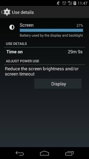

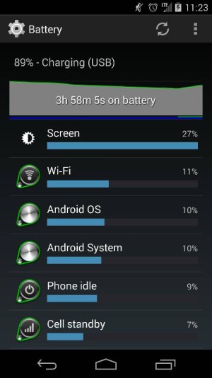

After following your suggestions I am at 85 percent battery after 3 hours off the charger. I surfed the web for 10 minutes, checked a few emails and send 5 texts. Does that seem normal to be down 15 percent in 3 hours on minimal use? Or do you think I should give factory reset a try?
Can you post screenshots of your battery stats?

Ok, those stats are still hard to interpret, because I just noticed that you'd been charging for some period of time. Let it run down normally for a while, then show us the same screenshots again (before plugging the charger in).

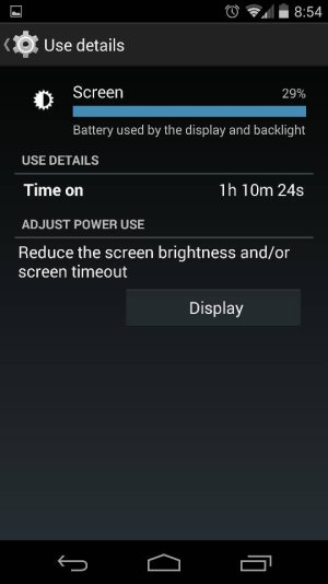

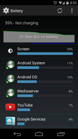

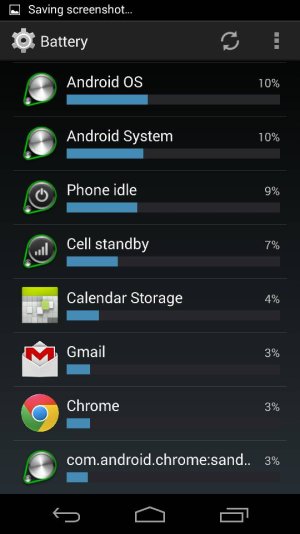

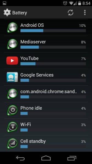

Here's after about 4 hours off the charger. This is average use for me... Just trying to gage if this is normal behavior. I keep reading about people going over 24 hours on a single charge. I'm lucky to make it 8-10.
That isn't great--you're on track for about 2.5 hours of screen on time, which is below average. When you were watching YouTube, were you using headphones, or was it playing over the speaker loudly? If the latter, that might have used a decent amount of juice. The other thing I notice is the alarm clock is set--I recall issues on my old Razr Maxx with very frequent wakelocks when an alarm was set. It might be worth seeing how the battery is without the alarm clock set.
