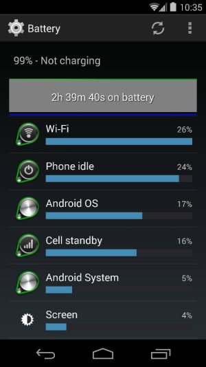

That isn't great--you're on track for about 2.5 hours of screen on time, which is below average. When you were watching YouTube, were you using headphones, or was it playing over the speaker loudly? If the latter, that might have used a decent amount of juice. The other thing I notice is the alarm clock is set--I recall issues on my old Razr Maxx with very frequent wakelocks when an alarm was set. It might be worth seeing how the battery is without the alarm clock set.
No headphones while on YouTube and yes the volume was almost maxed. I guess I'll try turning the alarm off but I'm the type that would forget to set it every night... Do you think a factory reset would do any good? Appreciate the help as always B diddy.
Factory reset never hurts, but it's just a hassle to reinstall everything and get it all set up again.

So I'm over 2 and a half hours on standby... I turned off the alarm and I am very pleased with the results.
