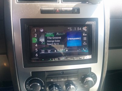

Bit the bullet: NEX4100 being installed this week.
