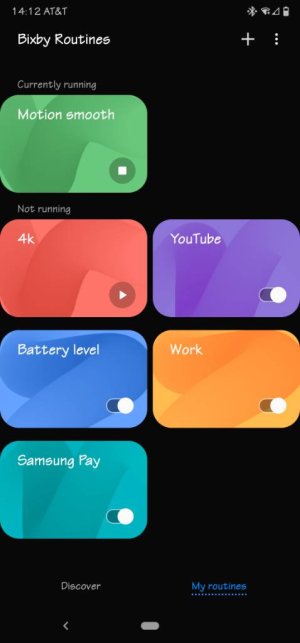

I haven't seen this mentioned but with the latest bixby routines you can set it up to switch between 1080/120 & 1440/60 now. Screenshot_20200912-141222_Bixby Routines.jpg

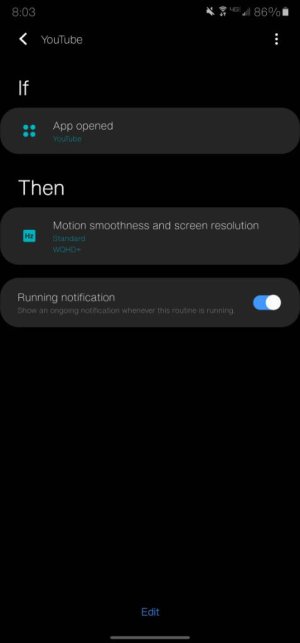

I just setup a bixby routine for it to play back youtube in 1440p when I open the app from the current display setting of FHD+ and 120hz. I updated bixby routines through the galaxy store also. I tested it out I open the YT app play a video I know can play back in 1440p and when I look at the video resolutions it maxed out at 1080p so this routine isn't working for me
I had that issue so I set bixby routine buttons to switch. Its a YouTube issue. You have to clear cache and data on YouTube for it to work when opening the YouTube app
Are you on mobile data, or WiFi? Most carriers limit streams to 1080 or 720 depending on your plan. With At&t I can't stream 1440 if I wanted to unless I'm on WiFi.
When exiting the above routine it returns to fhd but stays at 60hz. How do you set it so it reverts back to 120?

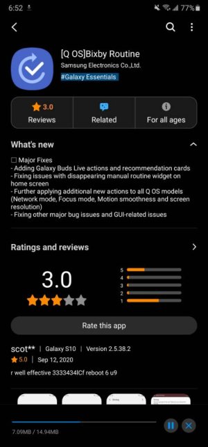

I also updated to the same 2.6.25.6.
When I try to set a routine up, IF.....THEN..... statement.
Under the THEN action, there is no galaxy buds live actions available to select. Does anyone know why? It does have Network mode, motion smoothness and screen resolution, start focus mode.
I also don't see the routines for buds live.
Anyone got resolution for this?
