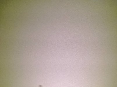

Hello, has anyone had troubles with the camera having a black spec? If I point at a white wall, it shows as a black spot.
I think there is a piece of dust in there or something? I didn't buy directly from Google, so I'll have to go through Bell for warranty I guess.
Anyone have experience with that? Hopefully they give me a new or refurbished phone! Mine is totally scratched up and dented.

It's not a stuck pixel on the screen, is it? Does it appear in the photo if you display it on a different device? Does it change size as you zoom in or out? I would think a piece of dust would show more like an amorphous off-color (not black) blob rather than a speck.

It's not pixel related. In all my photos and gets bigger when I zoom in. Really hope it's the sensor and not a tiny scratch on the lens.

Yup, that looks like dust all right. Could be either on the sensor or under the camera glass, but I'd make a guess at the sensor. With a strong light and a magnifier, you might be able to tell if its under the glass.
