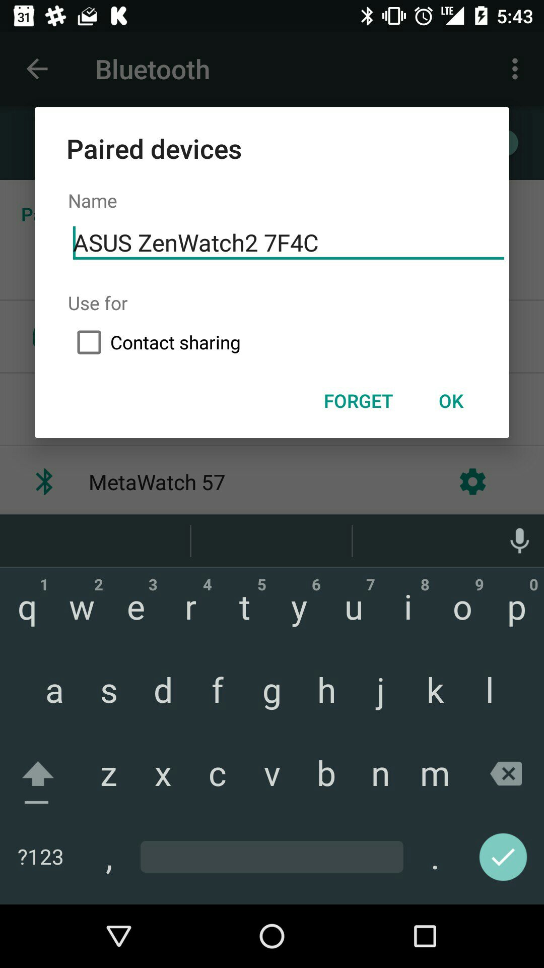

As B. Diddy mentions above, I wouldn't worry about accessing the Bluetooth settings... You take can't do much if anything there. Here is the Bluetooth system settings from my Nexus 5x and ZenWatch 2:
