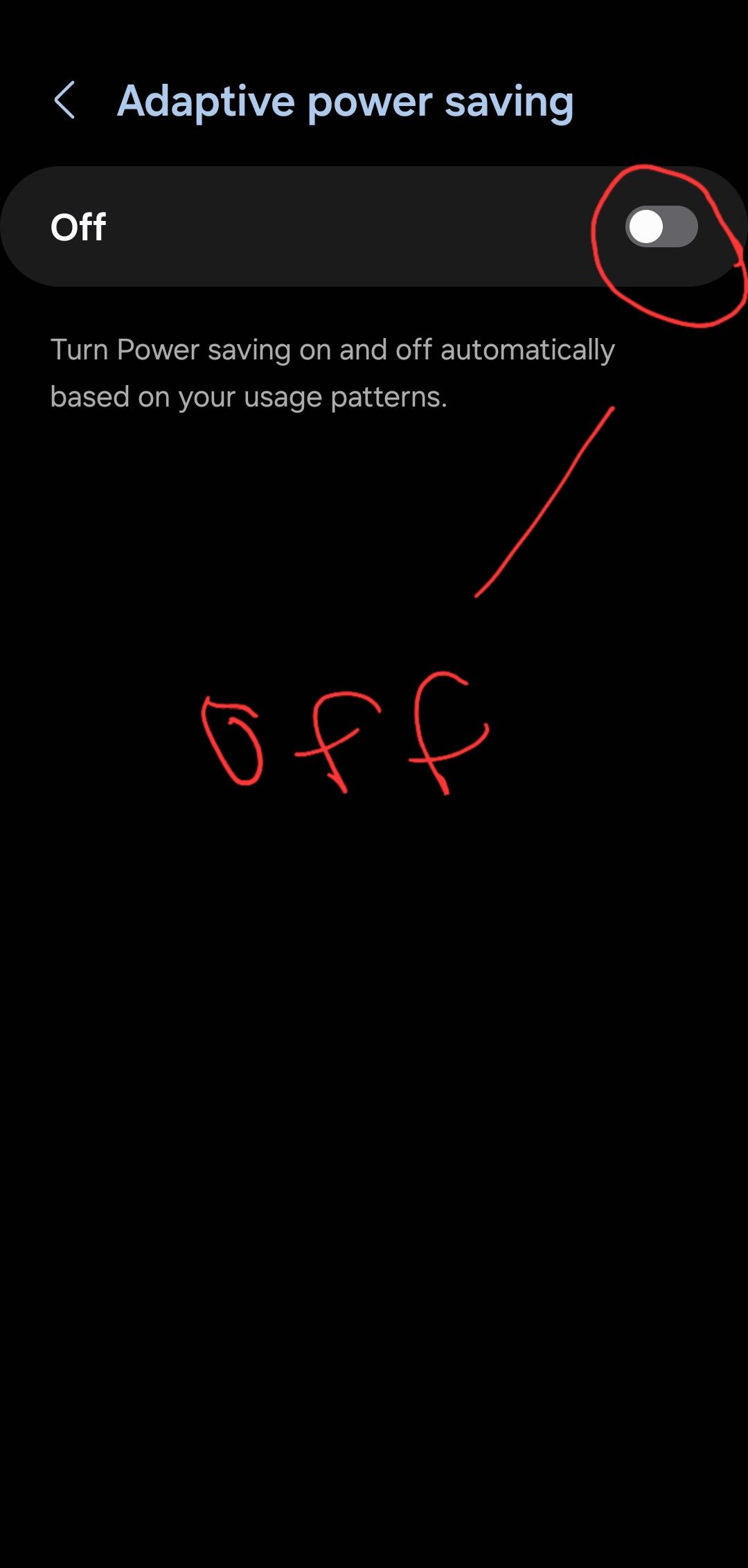

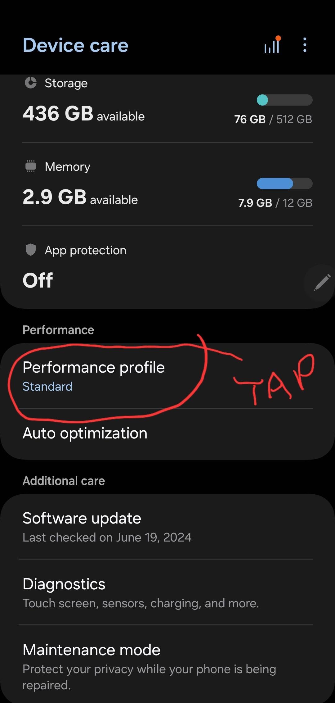

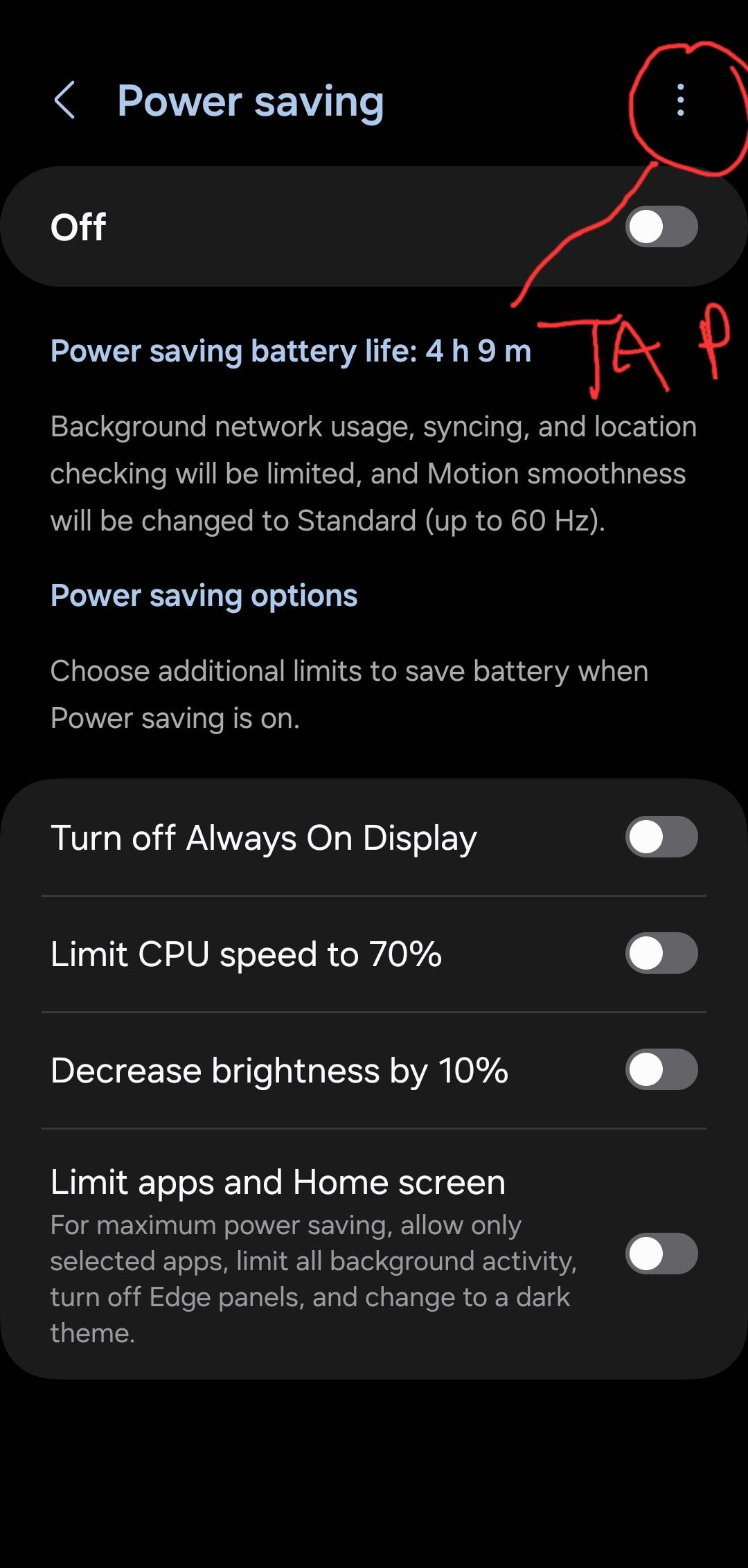

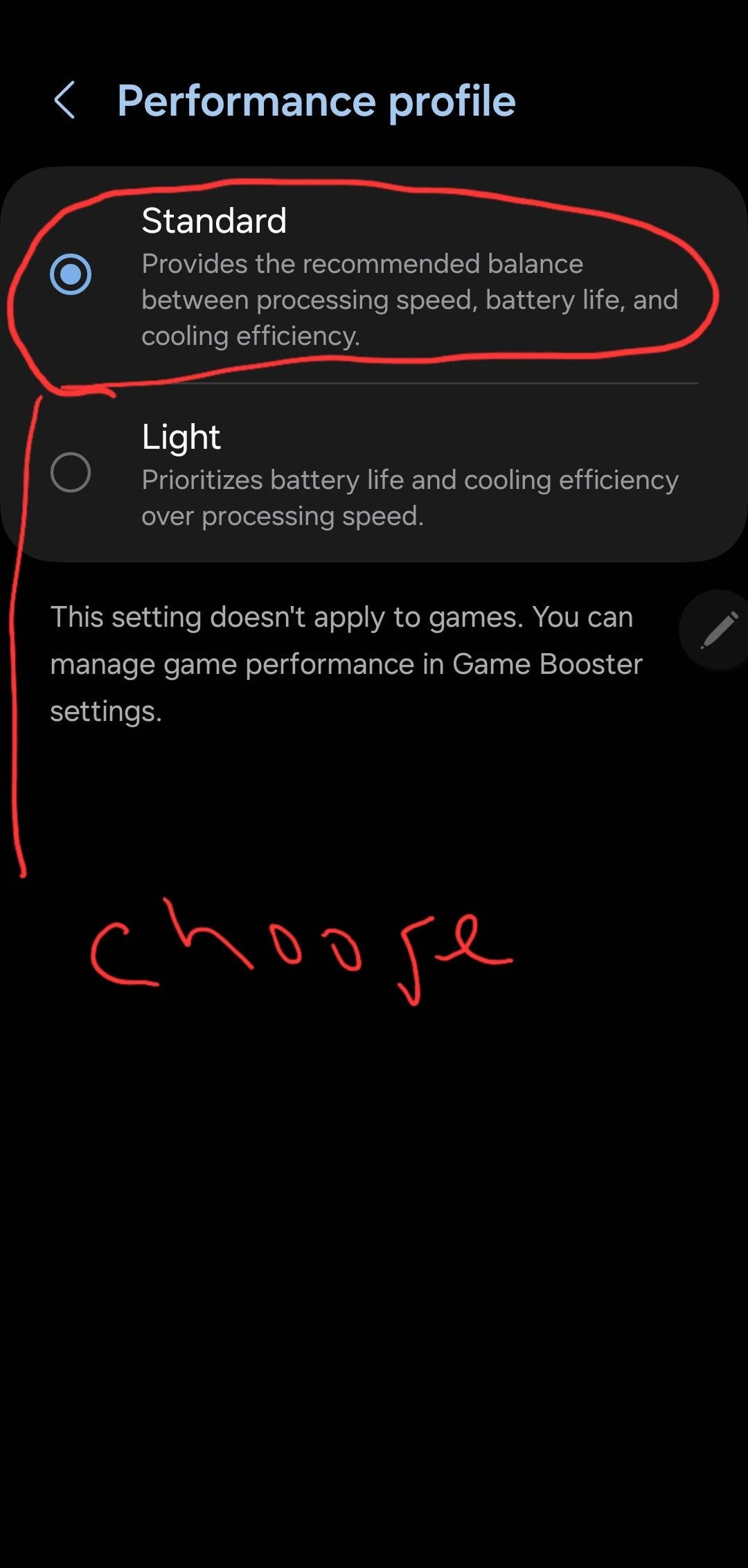

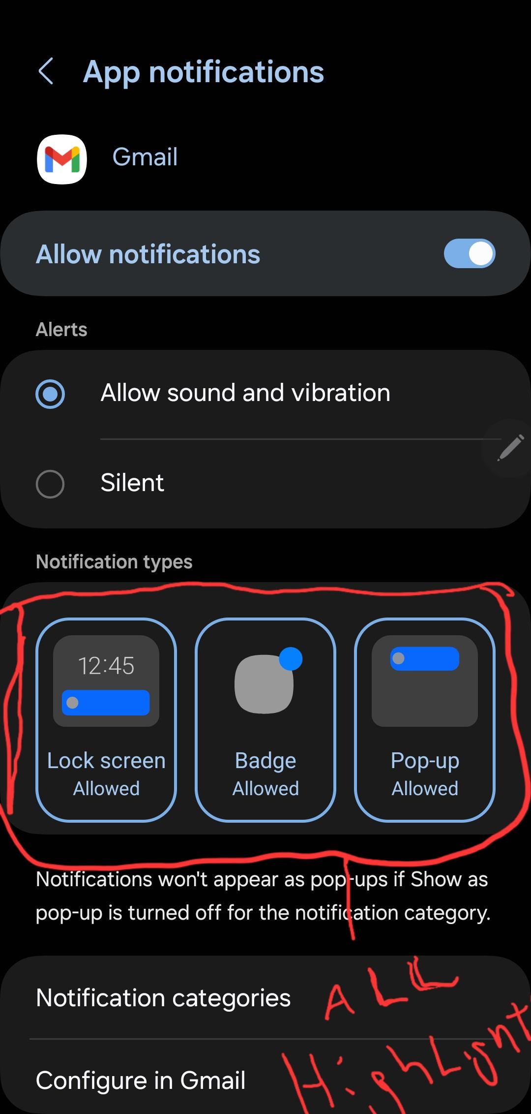

I'm going to give you a list of things to look at just give me a few to gather screenshots and block personal information of mine
Go to settings>Device Care
Check these settings to make sure they look like mine in the screen shot
  • Like
Reactions: Laura Knotek

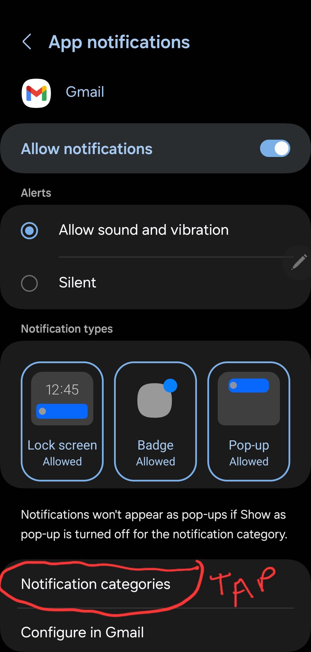

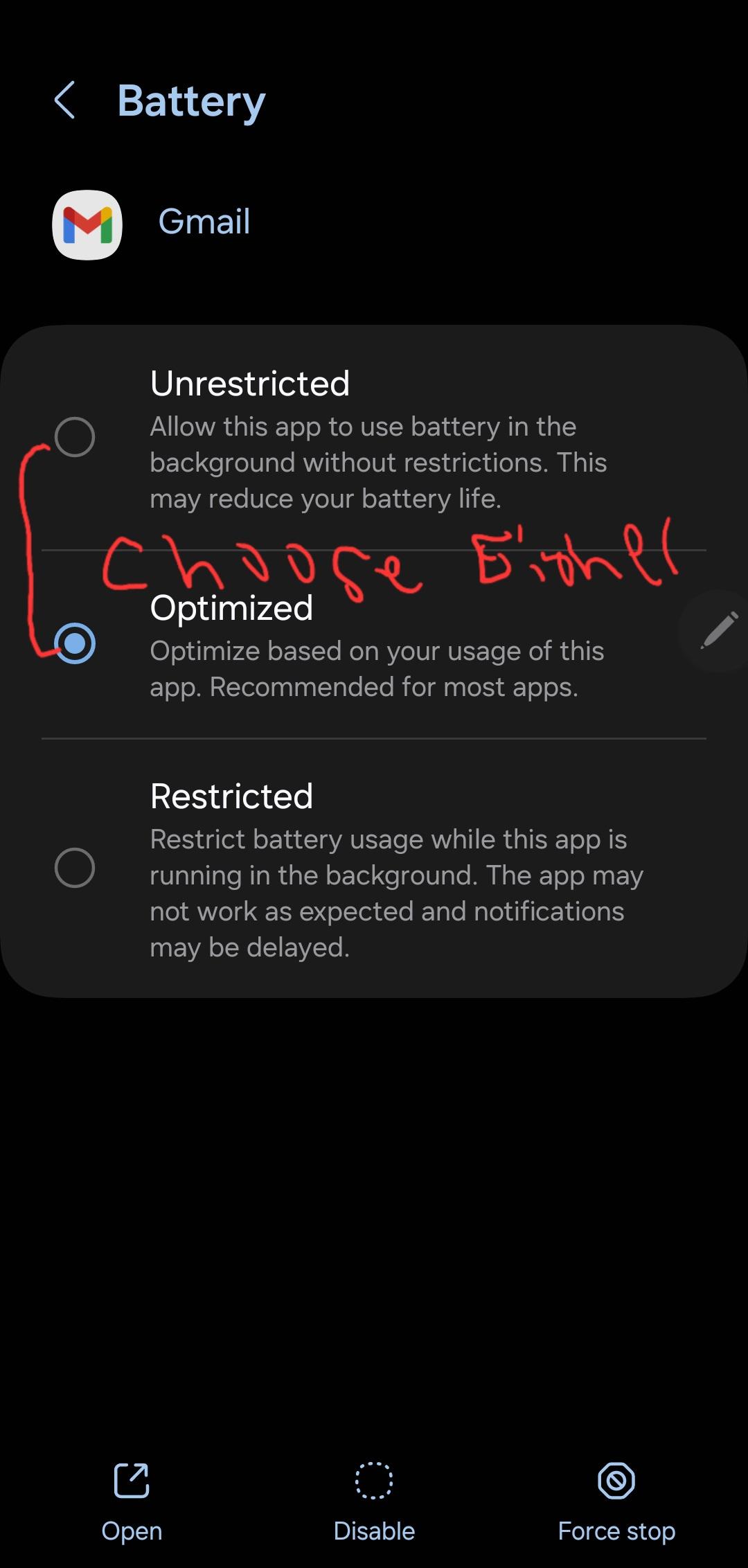

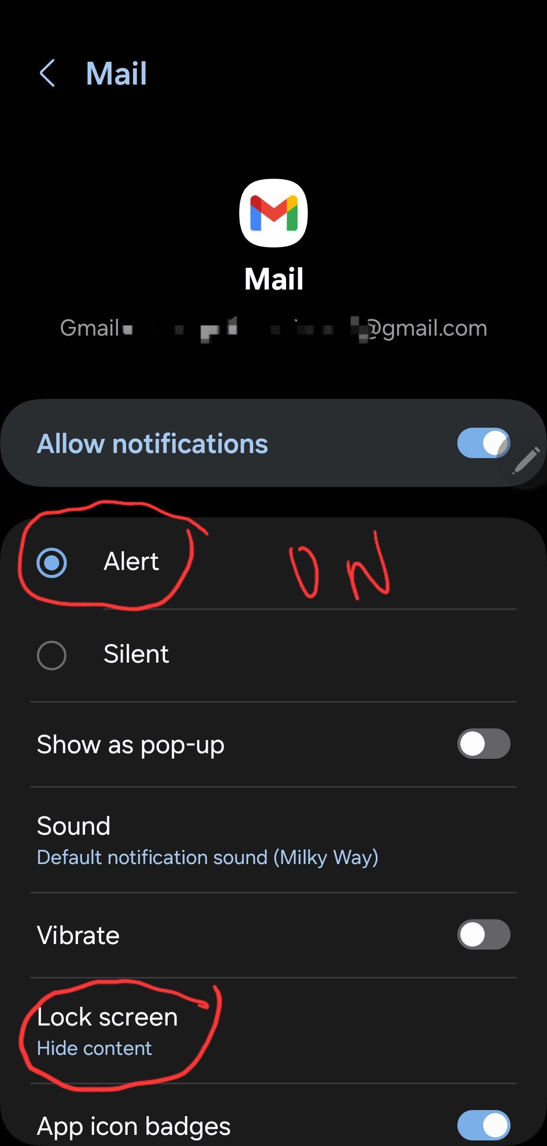

Now for Gmail app itself
Long press Gmail>tap info>notifications says allowed then tap on it to bring you to other menus and follow my screenshot
When you tap notifications categories each sub menu you can tap on to gain access to other menus
You're awesome, @mustang7757 . A lot of the menus look different for me, but I made any changes that weren't already set. For example, the only real difference I saw was that the "Performance Profile" was not there, but instead I found "Processing Speed" and set it to Maximum (out of Optimized, High, and Maximum."
I also added Gmail as an excluded app from "Memory checking."
