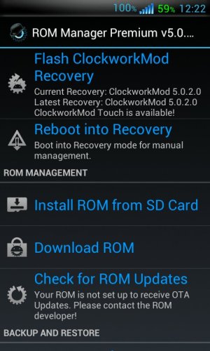

Where is that screenshot from cyanogen-man? It looks nice. I have CWM v3.0.0.6 because I think that was the latest version in May last year when I got this phone and immediately upgraded to Android 2.2. Or at least I thought it was the latest version at the time, I don't do much modding, just wanted 2.2 at the time and went through a guide.
