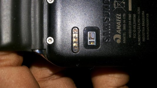

broken charging port
here is the replacement part "GH59-14036A"... now only if i could find a US Seller

How to fix the charging port. First pin is broken and I tried to find out every but could not find even the service centre of Samsung In dubai asking for to much money.
I have a Samsung gear 2

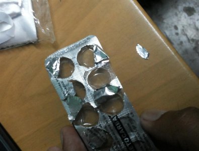

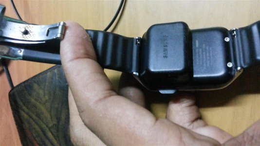

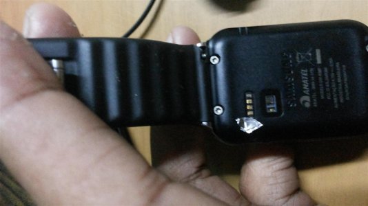

Hi..cuban and here aren't samsung' branch offices, and that happened to me and I did this:
......I hope work for you...

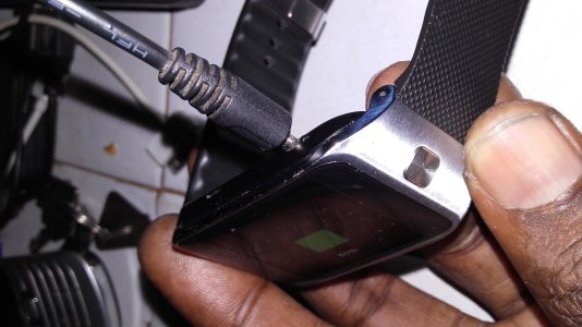

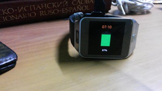

i have modified mine with small pin nokia charger it works very wellView attachment 231335
Whoa, why has no one asked Kobs Kane how the heck they managed to fix their watch with a Nokia charger?! I've got the same issue, I can order a new replacement charger connector board for ten bucks, but it'll take a month to get here from Hong Kong. How did you manage to do that? I've already disassembled the watch to find the root of the problem and split the charging connector board in half. Never seen anything like it before - it was definitely manufactured as two separate pieces and somehow fused together, but if I can get a fix to use my watch within the month it takes for the replacement, I'd be grateful since I've gotten used to this watch and am lost without it.
